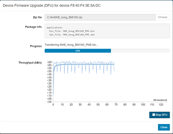

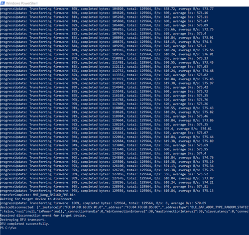

I tried DFU with NRF 52 DK board with 'PC-BLE-DRIVER-JS' dfu.js test code
When the firmware .zip file is 128 KB the speed of transftering the file is 600 Bytes / sec

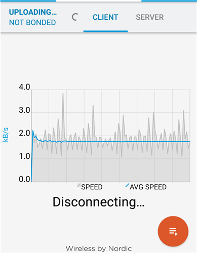

However When I try with NRF connect App on my Android phone (Sony Xperia XZ premium)
it has 1.6 KB / sec Which is way faster than when I tried with NTF52 DK board.
