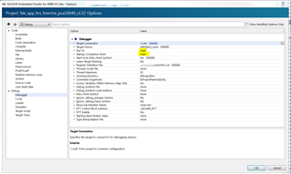

My project cannot be debugged using Segger Embedded Studio. The debugger doesn't halt at the application main and instead keeps running. Hitting a pause shows the debugger at 'SEV' instruction at address 0x0001304A (which seems to be from softdevice). I am using the softdevice s132v5.1 and the application uses freertos similar to the HRS example in SDK.
Any inputs on the reason for debugger behaving so?

    SES projects delivered in our SDKs are configured to break at main, and I verified this with the hrs freertos example in SDK 14.2.0. Have you tried this example?
    Debugger settings to break at main:
