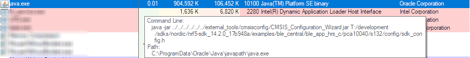

    In any case, since SES just launches the CMSIS config wizard as an external java process, I would suggest that you check (via task mgr or similar tool) whether a java process is instantiated when you launch the wizard. e.g. the following image highlights the java process launched on my system (along with the exact command string passed from the tools.xml config file)...

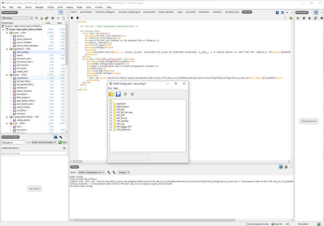

  • Ok Rafael,
    Since you're innovating in other areas, we decided to get innovative for you on this CMSIS Wizard thing to get it working under a Mesh SDK build and managed to successfully launch the Config Wizard under SES. The image below shows all the settings that we utilized... we imported an sdk_config.h file into the project since the tool is set to match on *config*.h files only. In the bottom output window you can also see the log generated by the wizard. Additionally as you can see, we pointed directly to the jar file that comes with the NRF5 SDK.
