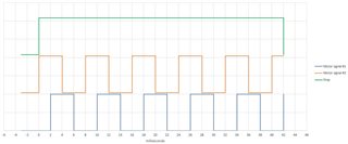

I need to drive a stepper motor without software intervention, since strict timing is a must.In the following image you can see the required wave-forms - the motor requires two PWM like signals, but i also need to be able to stop exactly after n cycles, where n can be from 1 to 1000. I saw the sample code added next, which generates the required wave-form, but have no way of stopping it after the n'th cycle, except by generating a timer SW interrupt where i stop the wave-form. But this is SW dependent  and i want fully automation.

    You can use the PPI FORK (for instance: NRF_PPI->FORK[0].TEP = (uint32_t) &NRF_TIMERx->TASKS_COUNT;) functionality to fork out one of the EVENTS_COMPARE to another TIMERx->TASKS_COUNT (additional timer needs to be init'ed correctly and started), then when the desired amount of TASKS_COUNT has been reached, you can stop the TIMER1 via another PPI channel.
    Remember that a timer in low power count mode requires a different init configuration compared to a "timer" configured timer.
    A side note: Please note that the timers start counting from zero, so in order to set a interval of 2 and 4 ms, you'll need to subtract one:
    NRF_TIMER1->CC[1] = 2000 - 1;
    NRF_TIMER1->CC[2] = 4000 - 1;

  • I managed to implement what you suggested by myself. Thanks a lot
