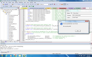

Hi, all

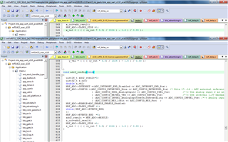

i have using adxl335 sensor interfacing ADC ;i have done code ,i wanted to know is it correct or the way i have developed the code can any one suggest me.
 How can i print those x,y,z value on UART and send via BLE.
  • Have you tested the code?
    Does it work? Or are you running into any issues?
    Maybe you could upload your code instead of the screenshots?
    Then I could test it myself.
    Joakim
  • ok ,i will upload that code

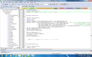

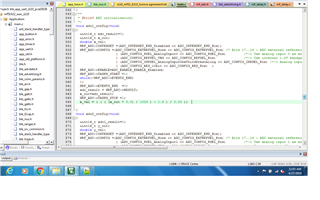

     * @brief ADC initialization.
    void adc1_config(void)
    	uint16_t adc_result=0;
    	uint16_t x_out;
    	double x_val;
    	NRF_ADC->INTENSET =(ADC_INTENSET_END_Disabled << ADC_INTENSET_END_Pos);
    	NRF_ADC->CONFIG =(ADC_CONFIG_EXTREFSEL_None << ADC_CONFIG_EXTREFSEL_Pos) /* Bits 17..16 : ADC external reference pin selection. */
    										| (ADC_CONFIG_PSEL_AnalogInput0 << ADC_CONFIG_PSEL_Pos)					/*!< Use analog input 0 as analog input. */
    										| (ADC_CONFIG_REFSEL_VBG << ADC_CONFIG_REFSEL_Pos)							/*!< Use internal 1.2V bandgap voltage as reference for conversion. */
    										| (ADC_CONFIG_INPSEL_AnalogInputOneThirdPrescaling << ADC_CONFIG_INPSEL_Pos) /*!< Analog input specified by PSEL with no prescaling used as input for the conversion. */
    										| (ADC_CONFIG_RES_10bit << ADC_CONFIG_RES_Pos)	;
    	NRF_ADC->ENABLE=ADC_ENABLE_ENABLE_Enabled;
    	NRF_ADC->TASKS_START =1;
    	while(!NRF_ADC->EVENTS_END)
    	NRF_ADC->EVENTS_END  =0;
    	adc_result = NRF_ADC->RESULT;
    	x_out=adc_result;
    	NRF_ADC->TASKS_STOP =1;
     	x_val = ( ( ( (x_out * 3.3) / 1024 ) - 1.6 ) / 0.33 );
    void adc2_config(void)
    	uint16_t adc1_result=0;
    	uint16_t y_out;
    	double y_val;
    										| (ADC_CONFIG_PSEL_AnalogInput1 << ADC_CONFIG_PSEL_Pos)					/*!< Use analog input 1 as analog input. */
    	adc1_result = NRF_ADC->RESULT;
    	y_out=adc1_result;
    	 	y_val = ( ( ( (y_out * 3.3) / 1024 ) - 1.6 ) / 0.33 );
    void adc3_config(void)
    	uint16_t adc2_result=0;
    	uint32_t z_out;
    	double z_val;
    										| (ADC_CONFIG_PSEL_AnalogInput2 << ADC_CONFIG_PSEL_Pos)					/*!< Use analog input 2 as analog input. */
    	adc2_result = NRF_ADC->RESULT;
    	z_out=adc2_result;
    	z_val = ( ( ( (z_out * 3.3) / 1024 ) - 1.6 ) / 0.33 );

    I'm using SDK 9.0.0 .
    how can i use that ble_nus_string_send() function in my code? here u can see
