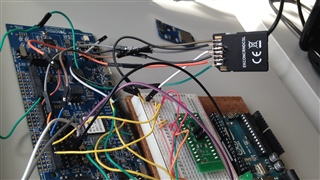

Hello all,
I have some troubles to initialize the micro SD card with my custom board.
I have used the nRF 52 DK to write a basic code and do some test. For micro card SD with the nRF 52 DK I have used this micro card SD reader
Here you can find the basic code. With my custom board the code can not do the initialization function. As the result disk_state = disk_initialize(0); is always true.

The file to configure the custom board is this one :
#include "boards.h"

and in the make file I have add the path to the file custom_board.h and I have changed the CFLAG like this
CFLAGS += -DBOARD_CUSTOM
# CFLAGS += -DBOARD_PCA10056
Do you have an idea why I can not initialize the micro SD card ?
When looking at the schematic if you find something strange with the antenna or related with the BLE you may have spotted another error as I can not connect to the BLE (but I am able to detect it ! ).
Thank you very much for the help. As you can understand when looking at the custom board schematic, I have spend a lot of time and energy on this project and I start to feel low when running in so complicated problem.

    I have tested the following things :
    - with nordic DK I have welded a SD card adaptor directly on SPI bus. I have tested without sd card reader if it is working and the answer is yes ! This is exactly the same circuit than the custom board. No SD card reader.
    SC adapter for micro SD card direct circuit for SPI bus using nordic DK
    - Using the custom board, I have downloaded a program that switch the pins (cs, clock, mosi, miso) to high and then enter an infinite loop which makes the debug led blinks. Using a voltmeter, I have checked that all pins deliver 3V when touching the pin on the sd card reader as shown check voltage ok
    To sum things up :
    The custom board is able to switch spi pins low to high (it is working). The code is working using the 'table' assembly (thank you Nordic). I don't have much ideas left to test.
