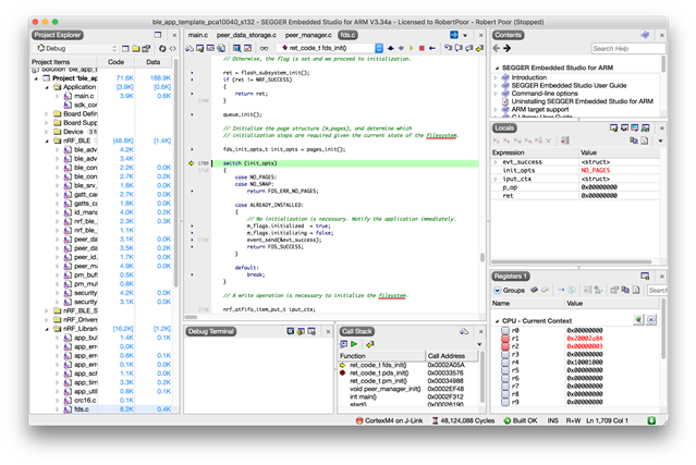

I downloaded the git repository verbatim and the project builds without error.  But when I download and run it, it dies inside the function:
main() => peer_manager_init() => pm_init() => pds_init() => fds_init()
with an FDS_ERR_NO_PAGES error.

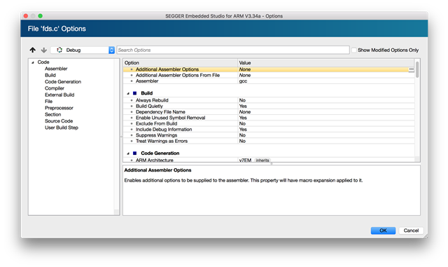

The problem with that is that, in my case, Edit Options shows only a Code section, not a Linker section.

  • FDS_ERR_NO_PAGES has nothing to do with RAM, its about your FLASH memory settings. Basically there is not enough free space between your app area and top-of-flash/bootloader.
  • Thanks for the clarification.  Is there a fix?  Or are you saying (indirectly) that the https://github.com/bjornspockeli/custom_ble_service_example example won't run on the nRF52832?
  • Just try to play a bit with LENGTH parameter of the flash in the linker script.
  • : The custom_ble_service_example should run without any issues on the nRF52832. There should be a Linker subsection under the Code section, if not, then please upload a screenshot of the Options window.

  • Hello Bjørn!
    Here's the screenshot of the window I get by clicking Project => Edit Options...
