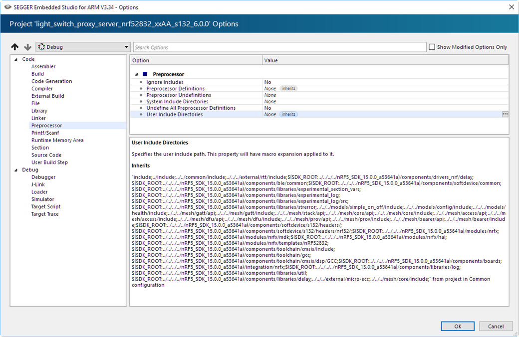

I would like to use a PWM application with mesh SDK. However when I try to compile, I got an error because "app_pwm.h" is missing (No such file or directory).
The only related topics I found was here and here but I guess this is outdated as "The nRF5 SDK for Mesh now requires the nRF5 SDK to compile. By default, the nRF5 SDK is expected to be adjacent to the nRF5 SDK for Mesh".
Can someone help me with this?

  • ok, you didn't include your error log in your original post so my initial observation was to highlight how to get the nRF5 SDK configured into a mesh solution...
    The app_pwm.h file is included in the nRF5 SDK so you may have to explicitly configure your SES settings to include the .\nrf5_sdk_15.0.0_a53641a\components\libraries\pwm directory into your build path (see below):
    Edit Options...->Preprocessor

    I explicitly configured my SES settings to include the .\nrf5_sdk_15.0.0_a53641a\components\libraries\pwm directory into your build path (as well as 2 other include file that were stated as missing in further Build attempts):
    I also added the file app_pwm.c to my project files under nRF SDK.
    However I got 7 errors like this when trying to Build again:
    What do I need to do more? Is there a sdk_config.h that needs to be edited as well in Mesh SDK?
  • Yes, examples in the mesh also have sdk_config.h (found in the include folder for the mesh example). here you need to set APP_PWM_ENABLED to 1
