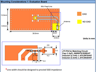

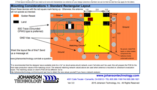

    - On the datasheet, there is always the no ground area (yellow) and the grounded area (orange). So I assume that I can put all the component that I need on the grounded area, but I should let the yellow area free of component am I right ?

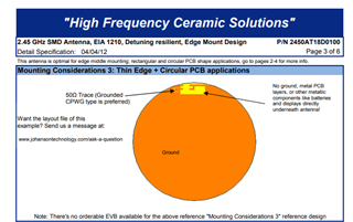

    -On the circular mount part 3, there is not the dimension of the no ground area, and no accurate schematic, should I take the mounting configuration 1 or 2? Or is the mounting consideration 1,2 and 4 are already made for a circular mount () what is the difference betwenn those if so ? ) ?
          Datasheet circular mounted scheme (no dimension) for the 2450AT18D0100 =>
          Datasheet regular mounted scheme (dimension) for the 2450AT18D0100 =>
    Correct, the no ground area (yellow) should be free of components, obstructions, traces, objects etc. and sized according to the datasheet. Components and other object should be placed on the ground area (orange), if most of the outer layers are covered by components etc. you should add an internal ground plane and keep it as 'solid' as possible (little/no trace routing).
    As for the circular PCB, either consideration should work fine, but for convenience it might be practical to use consideration 2, which leaves more of the radius for battery, etc underneath.
    As long as the transmission line has 50 ohm impedance it can be pretty much as long as you want. The longer it is though, the longer the transmission line loss will be, so you might not want to overdo it if possible.
