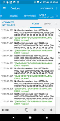

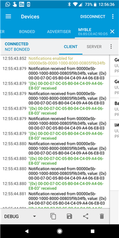

Ok, so I am using nRF52DK and trying to figure out to how to send up to 6 packets of data from custom service that sends 6 16bit values per packet. When I send one packet at a time everything is working ok. Once I call send 6 times in a row, I only see 5 packets arrive the first time and 4 packets all consecutive times. I am using nRF Connect app for android to see and communicate with the chip.

I have searched on how I can increase amount of data sent but everything that I have tried does not help me. If I reduce amount of data being send to lets say 1 value I see 6 packets come in. Does anyone have any idea how to solve the problem?
