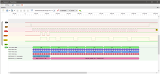

The problem is now, that i get the correct answer during the first procedure after power up.

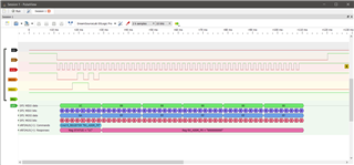

In the second procedure, i get only 0x00 except of the STATUS Register. This changes from 0x0E to 0x1C.
I have attached an logicanalyzer directly to the modules pins.
The result is attached.

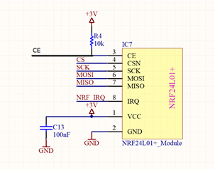

The Power is clean and come from an LDO, buffered with 100nF and 4.7uF MLCC directly at the module.
All Voltages are ~3.28V. Also for a high Level. And a low-level is around ~0.08V

First Command after PowerUp:
Second Command:
