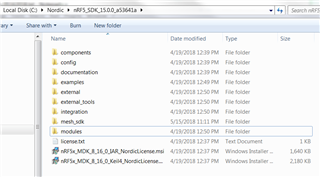

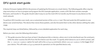

We used nRF5_SDK_15.0.0_a53641a and nrf5_SDK_for_Mesh_v2.0.0_src.

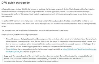

We are following DFU quick start guide http://infocenter.nordicsemi.com/index.jsp?topic=%2Fcom.nordic.infocenter.meshsdk.v0.10.0%2Findex.html
For nRF52:
For nRF52:

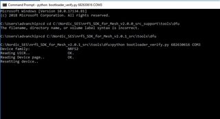

We started command prompt on an administrator. I have make sure all the steps before and after step 8 using s132 softdevice version 6.0. We tried to flash the program via both SES and nrfjprog (like shown in step 8). We also used difference Bud rate 115200, 57600, 38400, 19200, 14400 and 9600.
Attached are the cmd script file
Microsoft Windows [Version 6.1.7601] Copyright (c) 2009 Microsoft Corporation. All rights reserved. C:\Users\ALaw>cd C:\Nordic\nrf5_SDK_for_Mesh_v2.0.1_src C:\Nordic\nrf5_SDK_for_Mesh_v2.0.1_src>nrfutil keys --gen-key private_key.txt Generated key at: private_key.txt C:\Nordic\nrf5_SDK_for_Mesh_v2.0.1_src>nrfutil keys --show-vk hex private_key.tx t Verification key Qx: d78ea2728b31c63b185402f4209803b478d0828b02a0f44da9f5d782b04 7fe45 Verification key Qy: b60bf4db2e572b4b6053c0c7e9371b309c93ee53c300906afc6c7f2d99c e11cd C:\Nordic\nrf5_SDK_for_Mesh_v2.0.1_src>nrfutil dfu genpkg --application bin/blin ky/blinky_nrf52832_xxAA_s132_6.0.0.hex --company-id 0x00000059 --application-id 1 --application-version 2 --key-file private_key.txt --sd-req 0x009D --mesh dfu_ test.zip Key file was given, setting DFU version to 0.8 Zip created at dfu_test.zip C:\Nordic\nrf5_SDK_for_Mesh_v2.0.1_src>cd tools/dfu C:\Nordic\nrf5_SDK_for_Mesh_v2.0.1_src\tools\dfu>python device_page_generator.py -d nrf52832_xxAA -sd "s132_6.0.0" Wrote device page for nrf52832_xxAA with the s132_6.0.0 SoftDevice to bin/device _page_nrf52832_xxAA_s132_6.0.0.hex. C:\Nordic\nrf5_SDK_for_Mesh_v2.0.1_src\tools\dfu>cd .. C:\Nordic\nrf5_SDK_for_Mesh_v2.0.1_src\tools>cd .. C:\Nordic\nrf5_SDK_for_Mesh_v2.0.1_src>nrfjprog --eraseall Erasing user available code and UICR flash areas. Applying system reset. C:\Nordic\nrf5_SDK_for_Mesh_v2.0.1_src>nrfjprog --program bin/softdevice/s132_nr f52_6.0.0_softdevice.hex --chiperase Parsing hex file. Erasing user available code and UICR flash areas. Applying system reset. Checking that the area to write is not protected. Programming device. C:\Nordic\nrf5_SDK_for_Mesh_v2.0.1_src>nrfjprog --program bin/bootloader/armcc/m esh_bootloader_serial_armcc__nrf52832_xxAA.hex Parsing hex file. ERROR: The file specified could not be found. C:\Nordic\nrf5_SDK_for_Mesh_v2.0.1_src>nrfjprog --program bin/bootloader/armcc/m esh_bootloader_serial_armcc_nrf52832_xxAA.hex Parsing hex file. Reading flash area to program to guarantee it is erased. Checking that the area to write is not protected. Programming device. C:\Nordic\nrf5_SDK_for_Mesh_v2.0.1_src>nrfjprog --program examples\dfu\build\dfu _nrf52832_xxAA_s132_6.0.0_Debug\dfu_nrf52832_xxAA_s132_6.0.0.hex Parsing hex file. Reading flash area to program to guarantee it is erased. Checking that the area to write is not protected. Programming device. C:\Nordic\nrf5_SDK_for_Mesh_v2.0.1_src>nrfjprog --program tools/dfu/bin/device_p age_nrf52832_xxAA_s132_6.0.0.hex Parsing hex file. Reading flash area to program to guarantee it is erased. Checking that the area to write is not protected. Programming device. C:\Nordic\nrf5_SDK_for_Mesh_v2.0.1_src>nrfjprog --reset Applying system reset. Run. C:\Nordic\nrf5_SDK_for_Mesh_v2.0.1_src>nrfutil dfu serial -pkg dfu_test.zip -p C OM46 -b 115200 -fc --mesh Upgrading target on COM46 with DFU package C:\Nordic\nrf5_SDK_for_Mesh_v2.0.1_sr c\dfu_test.zip. Flow control is enabled. [------------------------------------] 0% Failed to upgrade target. Error is: Failed to establish connection Possible causes: - bootloader, SoftDevice or application on target does not match the requirement s in the DFU package. - baud rate or flow control is not the same as in the target bootloader. - target is not in DFU mode. If using the SDK examples, press Button 4 and RESET and release both to enter DFU mode. C:\Nordic\nrf5_SDK_for_Mesh_v2.0.1_src>nrfutil --verbose dfu serial -pkg dfu_tes t.zip -p COM46 -b 115200 -fc --mesh Upgrading target on COM46 with DFU package C:\Nordic\nrf5_SDK_for_Mesh_v2.0.1_sr c\dfu_test.zip. Flow control is enabled. [------------------------------------] 0%Flushing com-port... Opened com-port Starting DFU upgrade of type 4, SoftDevice size: 0, bootloader size: 0, applicat ion size: 1912 Sending DFU start packet, afterwards we wait for the flash on target to be initi alized before continuing. PC -> target: 0502aabbccdd PC -> target: 0502aabbccdd PC -> target: 0502aabbccdd PC -> target: 0502aabbccdd PC -> target: 0502aabbccdd Failed to upgrade target. Error is: Failed to establish connection Possible causes: - bootloader, SoftDevice or application on target does not match the requirement s in the DFU package. - baud rate or flow control is not the same as in the target bootloader. - target is not in DFU mode. If using the SDK examples, press Button 4 and RESET and release both to enter DFU mode. Closing serial port... C:\Nordic\nrf5_SDK_for_Mesh_v2.0.1_src>nrfutil dfu serial -pkg dfu_test.zip -p C OM46 -b 57600 -fc --mesh Upgrading target on COM46 with DFU package C:\Nordic\nrf5_SDK_for_Mesh_v2.0.1_sr c\dfu_test.zip. Flow control is enabled. [------------------------------------] 0% Failed to upgrade target. Error is: Failed to establish connection Possible causes: - bootloader, SoftDevice or application on target does not match the requirement s in the DFU package. - baud rate or flow control is not the same as in the target bootloader. - target is not in DFU mode. If using the SDK examples, press Button 4 and RESET and release both to enter DFU mode. C:\Nordic\nrf5_SDK_for_Mesh_v2.0.1_src>nrfutil --verbose dfu serial -pkg dfu_tes t.zip -p COM46 -b 38400 -fc --mesh Upgrading target on COM46 with DFU package C:\Nordic\nrf5_SDK_for_Mesh_v2.0.1_sr c\dfu_test.zip. Flow control is enabled. [------------------------------------] 0%Flushing com-port... Opened com-port Starting DFU upgrade of type 4, SoftDevice size: 0, bootloader size: 0, applicat ion size: 1912 Sending DFU start packet, afterwards we wait for the flash on target to be initi alized before continuing. PC -> target: 0502aabbccdd PC -> target: 0502aabbccdd PC -> target: 0502aabbccdd PC -> target: 0502aabbccdd PC -> target: 0502aabbccdd Failed to upgrade target. Error is: Failed to establish connection Possible causes: - bootloader, SoftDevice or application on target does not match the requirement s in the DFU package. - baud rate or flow control is not the same as in the target bootloader. - target is not in DFU mode. If using the SDK examples, press Button 4 and RESET and release both to enter DFU mode. Closing serial port... C:\Nordic\nrf5_SDK_for_Mesh_v2.0.1_src>nrfutil --verbose dfu serial -pkg dfu_tes t.zip -p COM46 -b 19200 -fc --mesh Upgrading target on COM46 with DFU package C:\Nordic\nrf5_SDK_for_Mesh_v2.0.1_sr c\dfu_test.zip. Flow control is enabled. [------------------------------------] 0%Flushing com-port... Opened com-port Starting DFU upgrade of type 4, SoftDevice size: 0, bootloader size: 0, applicat ion size: 1912 Sending DFU start packet, afterwards we wait for the flash on target to be initi alized before continuing. PC -> target: 0502aabbccdd PC -> target: 0502aabbccdd PC -> target: 0502aabbccdd PC -> target: 0502aabbccdd PC -> target: 0502aabbccdd Failed to upgrade target. Error is: Failed to establish connection Possible causes: - bootloader, SoftDevice or application on target does not match the requirement s in the DFU package. - baud rate or flow control is not the same as in the target bootloader. - target is not in DFU mode. If using the SDK examples, press Button 4 and RESET and release both to enter DFU mode. Closing serial port... target -> PC: e8 C:\Nordic\nrf5_SDK_for_Mesh_v2.0.1_src>nrfutil --verbose dfu serial -pkg dfu_tes t.zip -p COM46 -b 14400 -fc --mesh Upgrading target on COM46 with DFU package C:\Nordic\nrf5_SDK_for_Mesh_v2.0.1_sr c\dfu_test.zip. Flow control is enabled. [------------------------------------] 0%Flushing com-port... Opened com-port Starting DFU upgrade of type 4, SoftDevice size: 0, bootloader size: 0, applicat ion size: 1912 Sending DFU start packet, afterwards we wait for the flash on target to be initi alized before continuing. PC -> target: 0502aabbccdd PC -> target: 0502aabbccdd PC -> target: 0502aabbccdd PC -> target: 0502aabbccdd PC -> target: 0502aabbccdd Failed to upgrade target. Error is: Failed to establish connection Possible causes: - bootloader, SoftDevice or application on target does not match the requirement s in the DFU package. - baud rate or flow control is not the same as in the target bootloader. - target is not in DFU mode. If using the SDK examples, press Button 4 and RESET and release both to enter DFU mode. Closing serial port... C:\Nordic\nrf5_SDK_for_Mesh_v2.0.1_src>nrfutil --verbose dfu serial -pkg dfu_tes t.zip -p COM46 -b 9600 -fc --mesh Upgrading target on COM46 with DFU package C:\Nordic\nrf5_SDK_for_Mesh_v2.0.1_sr c\dfu_test.zip. Flow control is enabled. [------------------------------------] 0%Flushing com-port... Opened com-port Starting DFU upgrade of type 4, SoftDevice size: 0, bootloader size: 0, applicat ion size: 1912 Sending DFU start packet, afterwards we wait for the flash on target to be initi alized before continuing. PC -> target: 0502aabbccdd PC -> target: 0502aabbccdd PC -> target: 0502aabbccdd PC -> target: 0502aabbccdd PC -> target: 0502aabbccdd Failed to upgrade target. Error is: Failed to establish connection Possible causes: - bootloader, SoftDevice or application on target does not match the requirement s in the DFU package. - baud rate or flow control is not the same as in the target bootloader. - target is not in DFU mode. If using the SDK examples, press Button 4 and RESET and release both to enter DFU mode. Closing serial port... C:\Nordic\nrf5_SDK_for_Mesh_v2.0.1_src> C:\Nordic\nrf5_SDK_for_Mesh_v2.0.1_src>

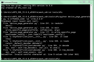

Step 2: bootloader_config_default.json
"bootloader_config": {
"bootloader_id": 1,
"bootloader_version": 1,
"company_id": 89,
"application_id": 1,
"application_version": 1,
"public_key":
"d78ea2728b31c63b185402f4209803b478d0828b02a0f44da9f5d782b047fe45b60bf4db2e572b4b6053c0c7e9371b309c93ee53c300906afc6c7f2d99ce11cd"

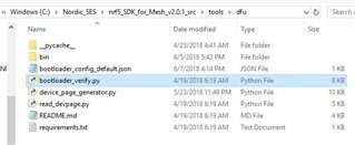

Step 3: dfu_test.zip dfu_test.zip
Step 4: Modified dfu_nrf52832_xxAA_s132_6.0.0.py from 5.0.0 to 6.0.0

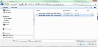

to generate
device_page_nrf52832_xxAA_s132_6.0.0.hex device_page_nrf52832_xxAA_s132_6.0.0.hex

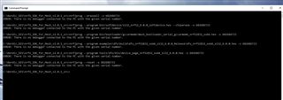

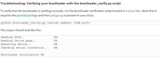

Step 7: s132_nrf52_6.0.0_softdevice.hex mesh_bootloader_serial_armcc_nrf52832_xxAA.hex
Step 8: Program device using nrfjprog to download dfu_nrf52832_xxAA_s132_6.0.0.hex dfu_nrf52832_xxAA_s132_6.0.0.hexdfu_nrf52832_xxAA_s132_6.0.0.map
Step 9: Program device_page_nrf52832_xxAA_s132_6.0.0.hex device_page_nrf52832_xxAA_s132_6.0.0.hex
Step 10: We tried difference Baud Rates, press Button 4 and RESET and release both to enter DFU mode and use s132 and version 6.0.0, still got
"Error is: Failed to establish connection"
Please advise. Thanks.
I got a few tips from a Mesh developer here at Nordic:
"The original issue seems to be an error in the json file. Looks like there is an extra "}" at the end, maybe.
Next, is the customer sure that the com port used is the correct com port?
The SEGGER DFU build had a known issue with the flash_placement.xml file. I would advise the customer to use some of the pre-compiled binaries to test the DFU first."
But I believe you have fixed the first issue, correct? I also believe you are using the correct com port & I believe you have used the pre-compiled binaries & not your own built hex files.
I am not sure these tips will help all too much, but it's worth giving it a shot!
I used gcc armemb. gcc armemb uses the GCC ARM compiler & armcc uses the compiler provided by keil. You need to add the nrfjprog -s command to all of the nrfjprog commands in this quick start guide.

I'm facing a problem in step 4 when i need to generate a hex version of device page, i did this :
dfu$ py device_page_generator.py -d nrf52832_xxAA -sd "s132_6.0.0"
and this is the result
Wrote device page for nrf53832_xxAA with the s132_6.0.0 SoftDevice to bin/device_page_nrf52832_xxAA_s132_5.0.0.hex instead of s132 version 6
here is the bin directory
I don't know why it doesn't generate device page with s132 v6.0.0, help please
