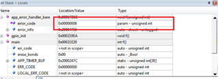

Thanks for supporting. Now i want to integrate GPIOTE with BLE UART example. When i  call gpio_init(); this function got error like below image.please support anyone
SDK : SDK12.3.0
Hardware : PCA10040
    Error code 0x08 means NRF_ERROR_INVALID_STATE, and is returned by the GPIOTE driver init function if the driver is already initialized.
    ble_app_uart example make use of the BSP library, which again use the application button library. The button library already initialize GPIOTE driver. You could add a check to make sure you do not initialize the driver if it is already initialized:
    if (!nrf_drv_gpiote_is_init())
        err_code = nrf_drv_gpiote_init();
    Jørgen

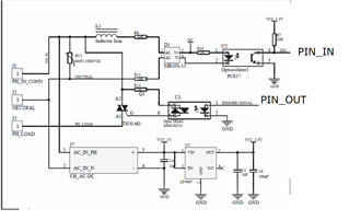

  • @ , Thanks for reply. your point is right. But i need both buttons_leds_init(&erase_bonds) and gpio_init() how can i use this.
    my project is AC FAN control using Dimmer concept. Please suggest me. My code

  • You cannot control the same GPIO using GPIOTE driver directly and with BSP LED module. Please redefined PIN_OUT to some other pin number than BSP_LED_0.
  • Yes i changed another GPIO for PIN_OUT but i faced same issue. When i comment this function (both buttons_leds_init(&erase_bonds) ) working good.
    Also i am faced one more issue like flickering for AC Dimmer. please suggest me how can i solve this ?
  • Did you change PIN_IN define as well? I'm not sure I understand what your issue is. Do you get any error codes? Something else not working as expected?
    I cannot help you with the "flickering for AC Dimmer" issue without you describing this issue in details. If it is not related to GPIOTE and this issue, you should create a new thread about this issue.
