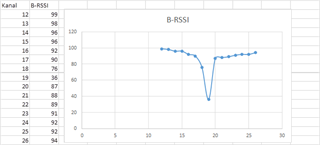

    c)
    Next test:
    Now we measure how good is the Nordic nrf receiver (RX) in suppressing strong signals.
    * Receiver develboard is reading background RSSI on Channel 19 (this should be 2440 MHz)
    * Sender develboard is sending continuous carrier on one defined channel (we start with channel 12)
    * Resulting RSSI on receiver board is identified
    * Sender is changed to next channel (now channel 13)
    * ... this is done for channel 12 to 26
    Here is the result
    Kanal  / RSSI Wert
    Develboard OFF /  101
    Kanal 12 / 99
    Kanal 13 / 98
    Kanal 14 / 96
    Kanal 15 / 96
    Kanal 16 / 92
    Kanal 17 / 90
    Kanal 18 / 76
    Kanal 19 / 36
    Kanal 20 / 87
    Kanal 21 / 88
    Kanal 22 / 89
    Kanal 23 / 91
    Kanal 24 / 92
    Kanal 25 / 92
    Kanal 26 / 94
    Is my interpretation correct:
    What i expect was that the RX "BandPassFilter" (what is the correct wording) is only 2 MHz wide. Any signal below or above that 2 MHz is filtered away.
    What is now see is that  the RX "BandPassFilter" is not selective enough to suppress strong wireless signals on other channels. This means that if a WLAN AP is in the near of an nrf device then this receiver "hears" a nois which is around  10dbm higher as without WLAN. This further means, that the resulting distance is reduced massively.

  • You can find the RX selectivity and RX intermodulation values in the datasheet:
    http://infocenter.nordicsemi.com/topic/com.nordic.infocenter.nrf52840.ps/radio.html?cp=2_0_0_5_19_14_5#unique_1352515260
    These tables describe how much higher an interference source can be relative to the desired channel without causing the packet to be lost.
    My recommendations are:
    - make guidelines on how to place the equipment away from for instance WIFI
    - make sure that you have optimized your design, for instance both verified output power and tuned the antennas to 50ohm nominal impedance (this must be done in actual casing). Because for every 1dB you may loose here, it will directly influence the coexistence performance.
    Kenneth
