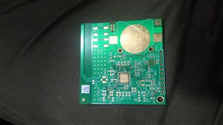

  • hi,
      i have uploaded the image of pcb before assembly of the components. in that J1 as not scratched.
  • We are still not communicating correctly. I wanted to see a photo of your board after you fixed your problem with J1.
    What I can see from the photo above it looks like you used the mostly correct artwork for the micro coax test port. But what you did wrong is that you placed the wrong connector for J1 instead of a micro coax test port.
    To fix this problem you can either buy the correct microcoax test port and place it.  Or, you can bypass the input and output with a chip cap or small piece of wire.  You do not and should not scratch any ground away. That is unnecessary and will keep the micro coax test port from working if you ever buy it.
    On your next spin, one thing you should fix is that the ground plane under J1 should be solid and not connected via small traces.  This ground plane is important for the connector to work correctly. Similarly the ground pads for the connector should not have thermals.  It should connect connect solidly to the surrounding ground and vias should be placed close to or even in the ground pad.

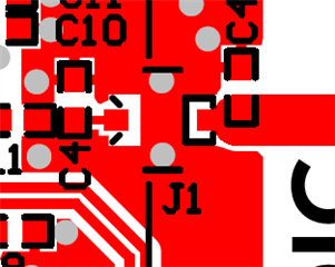

    For reference here is the correct artwork for the testport from the DK pcb:
    Please note the two vias inside of the ground pad.  These are very important. Simply placing them off to one side as you did is not sufficient. Also note, NO THERMALS!!!

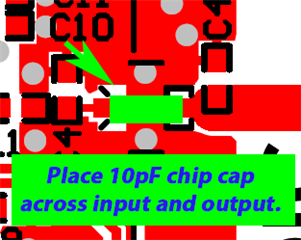

    If you don't ever intend to use the testport, and many people have no need for it, you can just bypass it in the artwork.  Here is a devzone question about that: https://devzone.nordicsemi.com/f/nordic-q-a/35133/pcb-antenna-nrf52810-eagle-files-does-it-need-extra-components-for-impedance-matching
    For your reference this is how you bypass J1.  Normally this can be accomplished with a 1206 or 0805 part.:

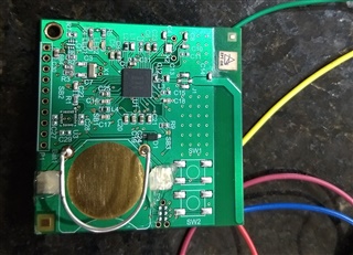

  • I'm developing custom board using nrf52840.
    Previously my ex-colleague was developing the board and now I'm taking care of this, so it would be helpful if you could assist me on completing the board.
    At present, the board is almost complete and I would need to check the design is correct as per guidelines.
    case ID: 207780 - This is the case ID used by the previous developer.
    I have attached below the image of the custom board,
    Can you please check the board and suggest me if this is correct ?
  • FormerMember
    0 FormerMember in reply to sathish2307
    The fix looks fine, what is the range now?
