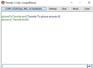

saying so. i do have problem flashing more complexe example on my nrf52832, for instance the proximity_ble example compiles and is flashed on the device without any error on Keil. but no phone can detect this device?
i have also noticed, that sometimes, flashing from Keil is mentionning that the content is flashed successfully as well as the program is running, while (either on the DKnr52 board or the external devices, the former program is still running.
Sorry for asking all my questions in the same message. but i try to move fast because i noticed that the nrf52832 seems having a low distance of fonctionning (few meters) the proximity app on my phone is mentionning that the signal is lost after few meters. Is that normal? if so, i might have to come back to my arduino and HC06 Bluetooth. I hope i misunderstood something about that.

Dear Martin, I am still connected to the external module the way i connected it for flashing it. It is not on P19 but P20 (which should be the same i guess). I did set Termite the way that is said into the documentation here, since it works perfectly with the module on board but not the external one
