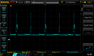

    I added a shunt resistor in the power supply line and measured the voltage (supply current) with a scope. I see peaks every ~48ms. I assume that the peaks in the supply current indicates that the nRF8001 is sending? Does this mean the connection interval is 48ms?
    See the voltage on the resistor:
  • Yes, this looks like the connection interval. Please note that the connection interval is set by the central device. The nRF8001 can only send a connection parameter update request, but it is up to the central if it wants to update the parameters or not.
