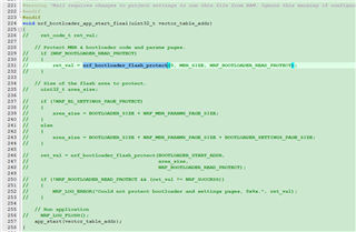

      I'm using SDK15.0, softdevice_v6 to Development NRF52832, which is developing a  non_security bootloader. The bootloader adapted from the example program can run normally in 0x72000, and can also normally boot successfully into the main program address 0x26000 (LED is blinking),J-Link RTT Viewer can output LOG of the bootloader. After the boot is successful, the LOG of the application is unable to output, while the application is running now (LED is blinking).
      It makes me very puzzled. Bootloader and application project use the same set of NRF LOG RTT configuration parameters.
      This similar phenomenon has also appeared in SDK14.0-14.2, but it is difficult for bootloader to export LOG, and the application can output LOG perfectly.
I also tried to use NRF_LOG_FLUSH (), and the result was invalid. Thankyou verymuch!
