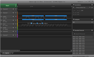

  • Been away from the project for a bit but I'm back now. I wanted to see if anyone could glance at my code and see what I'm doing wrong here.
    I'm trying to send data to a radio listening on channel 5, pipe 0. but I'm not seeing data.
    does CSN normally work with SS of the SPI?  OR does it need to go high at a manually controlled time. I just connected it to the active/inactive SS pin of the SPI. I also see talk about pulsing the line for 1ms, is this needed?
    This is my code from the sender. The comments should show my intentions. Though nothing is showing up on the receiving end.
    also the rf setup does not make any sense to me. Most people are setting it to 0x06 for 1MB but that looks like reserved to me and when set to 1MB in the Arduino code its a 0x01 that looks like 2MB? And what exactly does this mean? This bit is don’t care if RF_DR_LOW is set
    On my transmit end I use an arm. The SPI checks out (I see it on my analyzer)
    I manualy hold CE hi and I get 0x1e for each byte.

  • is this needed?
    //Pulse CE to start transmission
        SPI_CE = HIGH;
        __delay_ms(1);
        SPI_CE = LOW;
  • That is required, since the packet is triggered to be sent in TX. In RX is should be high all the time while receiving.
