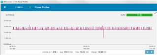

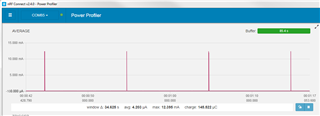

current consumption numbers for our SDK examples can easily be generated using the PPK and the Power Profiler application in nRF Connect.
BLE Beacon Advertising every 10 seconds
BLE Mesh Node (light_switch_server)
