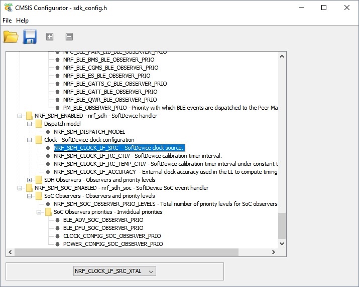

clock source on ble_app_uart
From what I understand the clock source for the example ble_app_uart is the 32 KHz external crystal. Please, see the screenshot of the CMSIS configurator:
How do I set the external 32 MHz crystal?
I am using the development board PCA10040, SDK 15 and softdevice 6.0.
Best regards
    As you may know there are two clock controllers in the nRF52, one high frequency (HF) and one low frequency (LF). As shown here, there are two sources for the HF clock:
    1. External crystal (HFXO)
    2. Internal oscillator (HFINT)
    and three for the LF clock:
    1. External crystal (LFXO)
    2. Internal oscillator (LFRC)
    3. Synthesized from the HF clock controller (LFSYNT).
    The settings you are referring to are used by the Softdevice to select LF clock source. I'm not sure if I understand your question, but LFSYNT is not intended to be used with the Softdevice. LFXO is better for current consumption, but obviously requires that your design has a crystal. If you don't have a crystal you can use LFRC instead.
    There is no need to specify HF clock source for the Softdevice. A HF crystal is mandatory, and the Softdevice will dynamically switch between HFXO and HFINT to save current.
