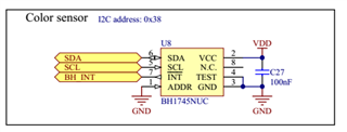

  • Actually I wanted to do a project where if I keep the Thingy on a surface,the thingy led shows the color of that surface automatically.I have the development kit nrf52832 but I don't have any idea how to program it for this particular project.
  • sorry for the late reply. This you can achieve on Thingy using its color sensor
    The specification of this sensor you can find here.
    You need to download the Thingy SDK and understand how the LEDs are controlled and use this sensor output to control the LED RGB value.
