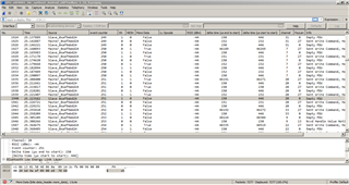

    You can do the 2 packets only in a burst (when only using the TX to push packets as fast as possible), as the TX buffers will be returned for use only after they are acked by the peer radio. Typical bandwidth on the TX will be 20 bytes (1 packet) per connection interval.
    The RX path typically has 3 packets per connection interval. My hypothesis is that the peak bandwidth of 2 packets in a connection interval (sustained) can be achieved only when the RX path is also sending 3 packets per connection interval. (See attached sniffer trace , viewable in Wireshark 2.6.1 as a support for my hypothesis)
