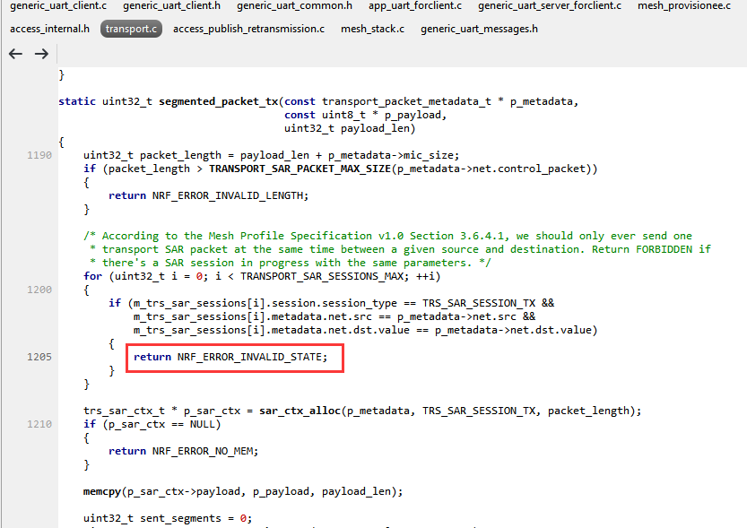

I am currently using two nRF52832 SDK boards to implement text message exchange with another nRF52832 SDK board via BLE Mesh SDK 2.0.1.
However, when I try to increase the frequency of sending the command the communication seem to choke. and i'm getting Roundtrip Delay higher between client and server.

    Sorry for the late reply. We are quite short staffed due to summer holiday here in Norway, so there is a little longer response time now, unfortunately.

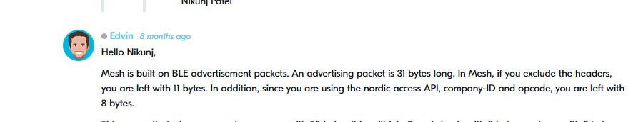

    What is the size of your Mesh Network, and how often do you send the messages?
    When you send the 11Byte message, I suspect that it is split into several messages, and hence will increase the roundtrip time.
    Check out what Thomas and leonwj wrote in this case.
    But yes, how many nodes are there in the network, and how often do you send the message?

    I had to ask a colleague of mine to look at your question. He had some questions about how you measure the delays. He writes:
    It doesn't look like he stamps the messages, so how does he know what message the server receives and answers to? It might have some implications on the measurements. Messages are not guaranteed to come in the right order in Mesh (although it is likely with only two nodes).The theoretical latency is ADV_INT/2 and default ADV_INT is 20ms.
