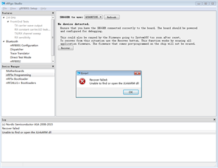

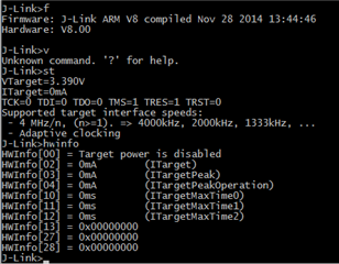

I can't connect to the core with the segger conmand.
also when I want to recover it ,it give me the follows:
so what can I do to solve it ?

I have delt with it. The jlink SN is illegal,so change the SN to normal is the way to solve it.
