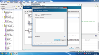

    If I want to add the missing source file into the answer provided, how should I do? Do I need to put them into Preprocessor definition? The figure below shows the interface that refers to preprocessor definition.
    I tried to drag the sources file directly into the project items but the software doesn't detect the source files.
    Any other way to solve this?
  • Could you please update your image to be bigger. I cannot read what it is saying. I would recommend taking a look at these youtube videos provided to get started with Segger Embedded Studios. You will need to include the header files in the preprocessor user include directories in SES. The source files (i.e. .c files) can be included in the folders by right clicking on the folder you want to include the source files in & pressing Add Existing File.

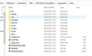

  • Hi Farhanah,
    Did you follow the steps provided here in Hung Bui's updated answer?
    I followed the steps provided after the comment "Attached here is an example combining ble_app_uart with light switch server. ":
    Just extract a new mesh sdk v2.0.1 into sdk15/components/mesh/. You will need to create a mesh folder. Then it should look similar to this:
    Add the example folder under ble_peripheral like shown:
    If you get a compile error regaring the _putchar function, take a look at the answer posted here. I tested this & the example compiled correctly without any issues.
