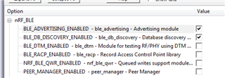

Hi.
I want to implement multirole on the nRF52832.
I want to advertise beacon data while scanning.
So, I modified ble_app_uart_c in the ble_central example.
Below is a description of what I have modified.

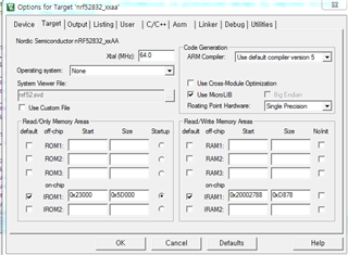

And, I modified ram size.
The 52832 uses a UUID to receive specific information from the smartphone and send specific information to the smartphone. At this time, I do not want to make a connection.
Trying to use the multirole in the example folder ble_central_and_peripheral, but  the same error occurred and could not be resolved.
https://devzone.nordicsemi.com/f/nordic-qa/23038/how-to-use-micro-ecc-without-loading-micro_ecc_lib_nrf52-lib
I am using nRF52832, PCA10040, s132, softdevice 3.0.0, sdk12.1.0.
