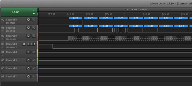

Like two of my predecessors, I am trying to put a CR95HF into operation. I chose the nRF52832 DK as MCU (SDK 15).

According to the data sheet of the CR95HF, the SPI interface works in 3 steps:
1. send command
2. poll with 0x03 until SPI return bit 3 to 1
3. send command 0x02 to read
The command is preceded by a control byte:
  • 0x00: Send command to the CR95HF
  • 0x03: Poll the CR95HF
  • 0x02: Read data from the CR95HF
  • 0x01: Reset the CR95HF
    The SPI_SS line is used to select a device on the common SPI bus. The SPI_SS pin is
    active low.
in the following you can see my code.

step 1, send the command:
[code]
nrf_gpio_pin_clear(SPI_SS_PIN);
spi_xfer_done = false;
APP_ERROR_CHECK(nrf_drv_spi_transfer(&spi, invcommand, 5, m_rx_buf, 5));
while (!spi_xfer_done){__WFE();}
nrf_gpio_pin_set(SPI_SS_PIN);
nrf_delay_ms(1);
[/code]

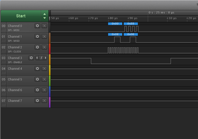

step 2, poll for data ready:
[code]
while(m_rx_buf[0] != 8) {
m_tx_buf[0] = 0x03;
APP_ERROR_CHECK(nrf_drv_spi_transfer(&spi, m_tx_buf, 1, m_rx_buf, 1));
m_rx_buf[0] = m_rx_buf[0] & 0x08;
nrf_delay_ms(1);
[/code]

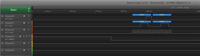

step 3, read the data:
[code]
memset(echo_idn, 0, sizeof(echo_idn));
APP_ERROR_CHECK(nrf_drv_spi_transfer(&spi, &read, 1, echo_idn, sizeof(echo_idn)));
nrf_delay_ms(1);
[/code]

as an answer from the CR95HF I get the following:
Picture 1Picture 2
Picture 3
On the first picture, you can see how I initialize the CR95HF (invcommand). on the second image, polling continues until bit nr. 3 becomes 1. on the last image, a tag should actually be read out. but I don't get anything useful there. where does that come from, what am I doing wrong? did i misunderstand the data sheet?
