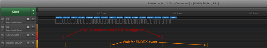

Previously, I used the nRF52832 with the interrupt-driven UART at 1Mbaud. But due to SoftDevice interrupts that blocked the UART-RX-IRQ for more than 6 bytes, I tried to use the UARTE with EasyDMA.
I need to receive an arbitrary amount of bytes and can therefore not wait until the RX buffer is filled. So, I tried the suggestion from this thread, by enabling the shortcut between ENDRX and STARTRX and by triggering the STOPRX task in a certain interval.
Now, I check in a certain interval if the RXDRDY event occurred. If yes, I set the second RX buffer as the active buffer and trigger afterwards the STOPRX task. After the ENDRX event occurred, I copy the amount of received bytes.

I assumed that due to the enabled shortcut the reception should immediately switch to the second buffer. But it seems that I lose some bytes (or get corrupted bytes) when the STOPRX task is executed during the reception of bytes. E.g. the byte stream "00 11 22 33 44 55 66 77 88 99 AA BB CC DD EE FF" is sent to the nRF52, but I receive in RX_BUF_1 the bytes "00 11 22 33 44 55 66" and in RX_BUF_2 the bytes "2C DB DD EE FF". Here is a trace from the flow:
Should the STOPRX task not be triggered during the reception of bytes or am I missing something? Do you know this problem?

    I have seen this method been attempted before, but unfortunately it is not possible to start and stop the UART asynchronously like this without concern for the incoming data stream. When you randomly start and stop the UART midstream like this, you will stop the logic, reset DMA channels, etc. at random times and you are bound to lose some bytes.
    In SDK 15 we have what we call the Command Line Interface library where one of the available transport layers are the UARTE. If you look in the source code for that ("SDK_folder\components\libraries\experimental_libuarte\nrf_libuarte.c") you can see how the SDK team has chosen to implement something similar. They don't start and stop the UART like this, but use PPI and a counter to keep track of how many bytes are available in the buffer. Maybe you can try something similar.

  • Thanks for your answer. I assumed that due to the shortcut, the reception would seamless continue in the second RX buffer. Seems that I was wrong. The solution with the PPI channel and the counter sounds promising.

    Yes, you are right. If you are only going to check the amounts of received bytes at ENDRX events you may just as well check RXD.AMOUNT rather than using a counter.
