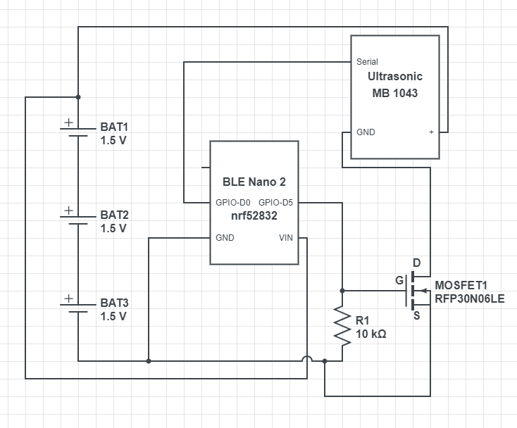

I have a RedBear BLE Nano v2 (nrf52832) connected to 3 AA batteries for power. I also have a Maxbotix (MB1043) ultrasonic sensor attached. I have configured a gpio pin for output and have connected it to an N-Channel MOSFET (RFP30N06LE) to be utilized as a switch. When the GPIO pin is set high, the MOSFET should complete the circuit and turn on the ultrasonic sensor.
The problem I am having is that the GPIO pin is not causing the MOSFET to complete the circuit. If instead, I supply the MOSFET gate with the battery, it works as expected and turns on the sensor. I measured the voltage and current as exactly the same from the battery as from the GPIO pin. So my question is why is the GPIO pin failing to activate the MOSFET?

  • Multiple issues maybe .. first 4.5 volts is way above the maximum rating for the nRF52832:
    Table 8: Absolute maximum ratings
                                      Min. Max. Unit
    Supply voltages
                     VDD        -0.3   +3.9   V
    I/O pin voltage        VDD ≤3.6 V -0.3 VDD + 0.3 V V
                                     VDD >3.6 V -0.3 3.9 V V
    Second when the FET is off the ultrasonic would backdrive GPIO-D0 if the Nano were changed to a lower VIN of <3.6 volts. A preferable circuit to turn on the Ultrasonic would be a FET in the supply, not the Gnd return, or often simpler just a low-dropout LDO with an Enable. With dual supplies two FETs are normally used if not using an LDO.
