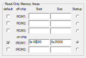

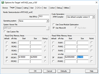

    I tried tweaking the IROM settings under target options to deal with potential softdevice overlap.
    It was originally-
    After referring to this i set it to-
    But even this did not fix my issue.

    Which version of the nRF51822 do you have? There's 3 different one's in terms of flash/RAM. The example is by default setup for the nRF51x22_QFAC device, which has 256 kB flash and 32 kB RAM.
    If you have the nRF51822_QFAAxx device, it is a 256 kB flash and 16 kB RAM, thus you need to adjust your settings:
    Note: there's also a version QFAB that has 128 kB flash and 16 kB RAM. See this page for more information about this: nRF51822 IC revision overview
