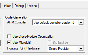

    I have set the include paths well also added to compiler list.
    This errors comes when I select ARM compiler option in Keil.
    Below are the errors occurs while selecting GCC ARM compiler.

  • I just use the default compiler in Keil under the Target tab:
    Have you taken a look at this link? Which path have you unzipped your sdk 15 version to? Mine is quite close to the C drive:
    C:\NordicSemi\SDKs\nRF5_SDK_15.0.0_a53641a
    If you have a really long path to the sdk 15 folder, this could lead to compile issues like you have noticed.
  • That path should be fine. Are you also using the default compiler version 5 that I am using? Did you take a look at the link I sent you?
  • Hi ,
    I went through the link you have shared and worked fine.
    Apologise for delay in response.
    Now I have custom board working with me.
