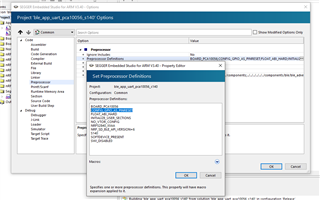

We have custom hardware that includes an NRF52832 microcontroller. Currently pin 0.21 is mapped as reset pin and i cannot seem to figure out how to change this using segger embedded studio. What we are trying to do is using the pin for other purposes then resetting the microcontroller.
I have found that i need to disable the define CONFIG_GPIO_AS_PINRESET, but i cannot seem to find it anywhere in my project. When i change the define in system_nrf52.c to CONFIG_GPIO_AS_PINRESET_x it still seems to use pin21 as Reset. Help would be very much appreciated to sort out this problem.
we are using SDK version 15.0.0

  • After removing the CONFIG_GPIO_AS_PINRESET it is important to load up nRFgoStudio and erase the chip before programming it again. This is what solved the problem for me.

    3. Navigate to Preprocessor Definitions:
      • In the Options dialog, expand the Preprocessor section under Common Configuration.
      • Click on Preprocessor Definitions.
    4. Add the Preprocessor Definition:
      • Add NRF_RESET_PIN=18 to the list of definitions.
      • Click OK to apply the changes.
