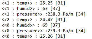

I found that some errors. The pressure data is taken to be about 200. But By Thingy mobile app, it was almost 1000.
Also If i connect many thingy, it couldn't recognize some thingy's environment services.
Actually I want to get motion data. But DK don't discover motion services all and it don't receive HVX event.
For these reasons, the project is no longer in progress.
What should i have to?
