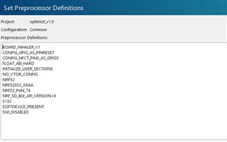

Hi everyone.  I'm starting from scratch and using as reference the example/ble_peripheral/ble_app_template.
I'm using Embedded Studio 3.50 + Jlink V6.32 / The chip is nRF52832-QFAA / The SDK15.0.0  + S132 SoftDevice v6.0.0
I designed a custom board, I defined the new board, as you can see in the PREPROCESSOR DEFINITIONS. (I used the example definition as reference)
I quite new using softdevice.
When I tried to start the timer, it couldn't.
Then I found a lot of threads in the forum explaining that you must request the low-frequency clock ( if you don't use the soft-device).
But I'm using the softdevice, and It seems that is not requesting the LFCLK.
Then I found this post https://devzone.nordicsemi.com/f/nordic-q-a/31982/can-t-make-app_timer-work  I added the lines and now the timer is working.
But I'm a little concerned because of the softdevice is not requesting LFCK automatically, and maybe I missed to set something in the sdk_config.h or maybe I'm not compiling a library/driver etc.
I read the documentation and I can't find a list of dependencies or required libraries/drivers to compile with.
Here are how I'm creating the timer and the handlers

the Preprocessor definitions,
all the files compiled
and the sdk_config file.
