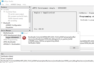

when I program the boot loader(examples\dfu\secure_bootloader\pca10056_ble) code to nRF52840DK, it's always report "Verification failed "
    I see. I just tested, and both the projects, pca10056_ble_debug and pca10056_uart_debug, and all other pca10056 bootloader projects seem to fail the verification in nRFgo Studio.
    It seems like a bug in the nRFgo Studio, since I can program the projects both using Keil directly, or nrfjprog/command line tools.
    While nRFgo Studio works (mostly), it is not being maintained anymore. I suggest that you look into using nrfjprog, (command line tools). I'm mixing up the names "command line tools" and "nrjfprog", but they are the same thing.
    You can download the command line tools (v7.3.1) here. Make sure to add the tool to your environment path if you are asked during the installation. When added, you can use this tool from all folders in cmd.
    Everything you can do in nRFgo Studio, you can also do in nrfjprog.
    Typically, navigate to the folder where the file you want to install is located in windows explorer. Type "Alt + d" to go to the address field, type "cmd" and press enter, and a cmd window should open in that folder.
