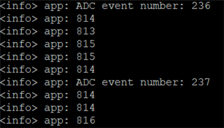

I run the example given in SDK V15.0.0 to measure Vdd of nRF52-DK:
NRF_DRV_SAADC_DEFAULT_CHANNEL_CONFIG_SE(NRF_SAADC_INPUT_VDD);
I don't change the default param:
- resolution = 10 bits
- ref = 0.6V
- gain = 1/6
As seen in console, I obtain an average value of 815
which gives:  815* 0.6 / 1024 * 6 = 2.87 Volts which is right for the nRF52832.
The problem is that if I change the resolution (to 8 bits or 14 bits) then I keep finding the same value of 815 ...  how do you explain that?
John.

  • Yes you're right!   I just realized I were changing this one instead:
    #ifndef NRFX_SAADC_CONFIG_RESOLUTION
    #define NRFX_SAADC_CONFIG_RESOLUTION 0
    It's confusing because these 2 drivers are enabled in the example given in SDK:
    And the NRFX can be unchecked in there. Which is strange BTW because the NFRX_ are supposed to be the new versions and the other one whitout the prefix NFRX_ is the legacy one.
    Thanks.
