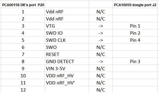

  • Hi Bjørn
    I have discovered that when I am trying to program the dongles (Via the external target Jlink pass through on the nRF52 DK), that I am actually (unwittingly) programming the target device on the DK board and not the dongle - it looks as though this is caused by the 0V detection circuit not working (which is used by the DK to change to an external target).... If I plug the dongle into my PCs USB port instead of the USB power adaptor it all programs and runs fine. Probably something to do with the USB power adaptor having an isolated 0V, so the DK doesn't detect the need for an external Jtag swap over
    My connection from the PCA00156 DK's P20 port to the PCA10059 dongle is as follows:
    Do you see any problem with this wiring or how it could be improved to make sure erasing and programming functions correctly independently of where the USB power derives from ??
    I have no connection to Pin 5 (VBUS) of J2 on the dongle.... does this cause a problem??

  • Hi Michael,
    Very sorry for the delayed response. You can download the HW files of the dongle & 52840 dev kit here & here. The version should be written the back of the dongle & the top of the interface MCU on the 52840 dev kit. I believe you could use J2 on the dongle, but as you can see from the image below, you would need to use the VBUS voltage from the usb like you have mentioned to program the dongle:
    Here is the P20 snapshot for reference:
    If you use the P1 port instead, I believe it might be a bit easier, as you do not require the VBUS voltage:
    Here is a snapshot of the debug out connector on the pca10056 dev kit for reference:
    Also, if you take a look at the infocenter documentation, you can see this text at the bottom:
    "If it is inconvenient to have a separate power supply on the external board, the nRF52840 DK board can supply power through the Debug out connector (P19). To enable this, short solder bridge SB47. Note that as long as SB47 is shorted, it is not possible to program the onboard nRF52840 SoC even if the external board is unplugged. "
    I would try using P19 on the dev kit along with the P1 connector on the dongle if you can. I believe that might be easier than using J2 on the dongle.
