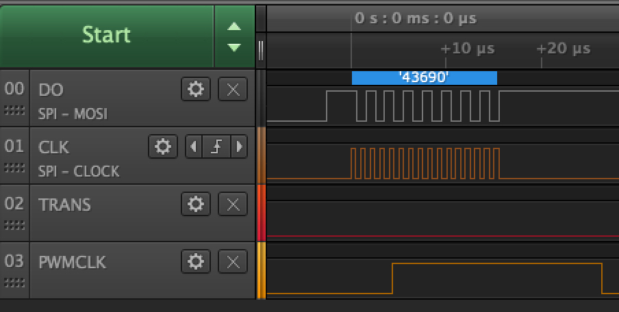

I'm attempting to use PPI and Timer2 on the NRF52810 to count the clock pulses coming out of the SPIM driver. As there is no way to do this internally (as far as I know) I tied another GPIO pin to the clock pin. The idea being here is that I want to toggle a separate "latch" pin at different places during the serialization process. With the latch pin active at different clock cycles, it signifies a different command in the LED driver I'm using. Ex. Latch pin high for 16 bits is one while only active for the last two bits is a completely different command.
I've had some success with but not 100%. Here's some code:

If I fork the assignment for m_latch_in_channel I get 15 ticks (when it should be 16). If I don't, I get zero or the value that's reflected in nrfx_timer_compare(&m_counter, NRF_TIMER_CC_CHANNEL0, 5, false); no matter how many clock pulses there are.
I'm stumped to say the least. Any insight is appreciated!

    I was using the wrong compare event to toggle the output gpio. (should use nrfx_timer_event_address_get). To get the count I used this guy:
    nrfx_timer_capture(&m_counter, NRF_TIMER_CC_CHANNEL1);
    Toggles at te 5th bit as expected. Though a little delayed.
