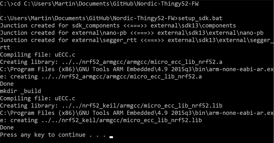

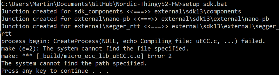

The problem reported in the command window is shown below....
I believe the source code file uECC.c is found ok because if I rename it I get a different message which states that it cannot find the source file.
Suspecting that the path to the Compiler/Toolchain was somehow incorrect I changed it to this...
# GNU_INSTALL_ROOT := C:/Program Files (x86)/GNU Tools ARM Embedded/4.9 2015q3/bin
PROGFILES=C:/Program Files (x86)
GNU_INSTALL_ROOT := $(PROGFILES)/GNU Tools ARM Embedded/4.9 2015q3/
GNU_VERSION := 4.9.3
GNU_PREFIX := arm-none-eabi
and I tried some other permutations here but I can't see to resolve the build error. The directories and paths appear correct.
