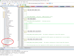

I can't import the nrf_serial library ( and nrf_queue ) on the ble_app_uart project, after that i compile, i read these errors :
linking...
.\_build\nrf52840_xxaa.axf: Error: L6218E: Undefined symbol nrfx_power_irq_enabled (referred from nrfx_clock.o).
.\_build\nrf52840_xxaa.axf: Error: L6218E: Undefined symbol nrfx_power_irq_handler (referred from nrfx_power_clock.o).
.\_build\nrf52840_xxaa.axf: Error: L6218E: Undefined symbol nrf_queue_in (referred from nrf_serial.o).
.\_build\nrf52840_xxaa.axf: Error: L6218E: Undefined symbol nrf_queue_is_empty (referred from nrf_serial.o).
.\_build\nrf52840_xxaa.axf: Error: L6218E: Undefined symbol nrf_queue_out (referred from nrf_serial.o).
.\_build\nrf52840_xxaa.axf: Error: L6218E: Undefined symbol nrf_queue_reset (referred from nrf_serial.o).
Not enough information to list image symbols.
Not enough information to list load addresses in the image map.
Finished: 2 information, 0 warning and 6 error messages.
".\_build\nrf52840_xxaa.axf" - 6 Error(s), 0 Warning(s).
Target not created.
Build Time Elapsed: 00:01:12

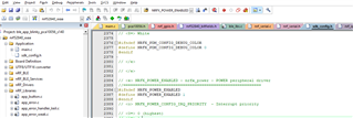

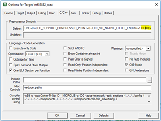

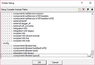

I include the library paths in options for Target 'nrf52840_xxaa' -> C/C++ :

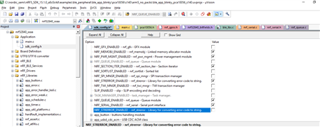

And i have modify the sdk_config.h in this way:
Where is the problema ? It is very urgent !!!
