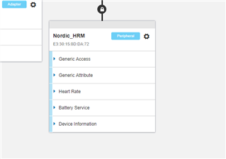

    Just compile and download. Open nRF Connect, and scan for devices.
    Connect to Nordic_HRM. Click then on the options buttion on the right side off Peripheral.

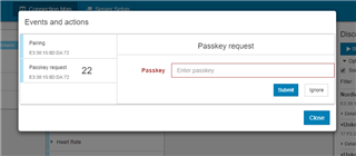

    Click on "Pair..", select Perform bonding, and click Pair.
    You should then get a new window where you type your passkey, like shown under:

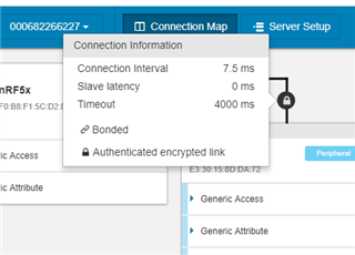

    After you have clicked on Submit, the BLE link should now be bonded and encrypted as you see below:
