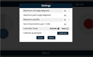

    but attitude mode is joystick throttle not OK. Unconditionally motor is 100% on.

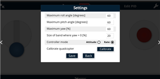

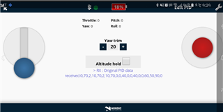

    1. Bluetooth connection will receive the PID
    2. calibarate click after controller mode is Rate mode.

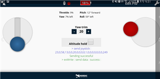

    3. According to the first data- 23 of the send joystick, the motor also operates as 23.
    Because of the capture, please understand that the joystick movements and values are different.
    4. calibarate click after controller mode is Attitude mode.
    The joystick operation is the same as the data in Figure 3
    However, the motor operates at 100%
    maybe do not read the throttle value
    It seems that the gyro & accelerometer might not be calibrated correctly. When you press the "calibrate quadcopter" button, only the offset is adjusted. It does not run a complete calibration. I would calibrate both the gyro & accelerometer correctly & then also tune the regulator if necessary.
