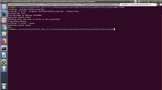

I am using Linux platform and soft-device s132 and armgcc compiler. I was able to flash successfully the example "blinky" code in the SDK path: "nRF5_SDK_15.0.0_a53641a/examples/peripheral/blinky" using nRF52 Development Kit's SWD pins in P20 headers. The connection is as follows:
VTG of DK -> VCC of custom board, SWDIO of DK -> SWDIO of custom board, SWDCLK of DK -> SWDCLK of custom board, GND DETECT of DK ->GND of DK and GND of custom board.
You can see below the screenshot attached that shows successful flashing of the code. Since the DK retained its previous code, I assume that I successfully flashed my custom board and not the Development Board. Is this the right assumption?
