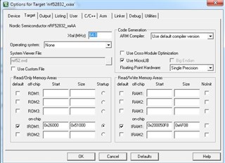

  • My flash settings:
    Yes, information stored into flash via fds. #define FDS_ENABLED 1, #define FDS_VIRTUAL_PAGES 3
    Any idea?
  • Ah, there we have it, then. You write that you use a debug bootloader starting at address 0x72000. Below there you have three FDS pages, which is 3*4*1024 = 0x3000, so they start at 0x6F000, which is below your fixed data starting at 0x71400, so they overlap. This means that when your application initializes FDS it writes to the flash area that is within the application region, which in turn will result in a different CRC (as it should). You simply have to move the fixed below the FDS pages to correct this.
