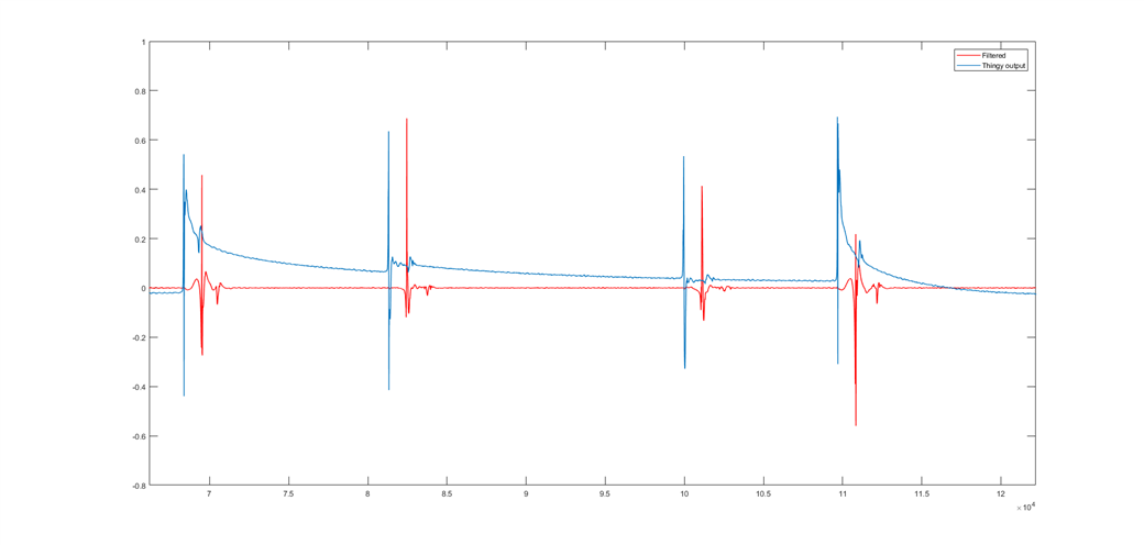

I've been evaluating the PDM hardware driver for the nRF52832, and the PCM output of Thingy. I've found that, for certain impulses at the input of the microphone, the PCM output signal results overdamped and this generates some seconds of distorted audio.
I think that a high pass filter wich removes frequencies under 10/20 Hz would mitigate this effect. Is there any plan to include something like that within the PDM driver?
