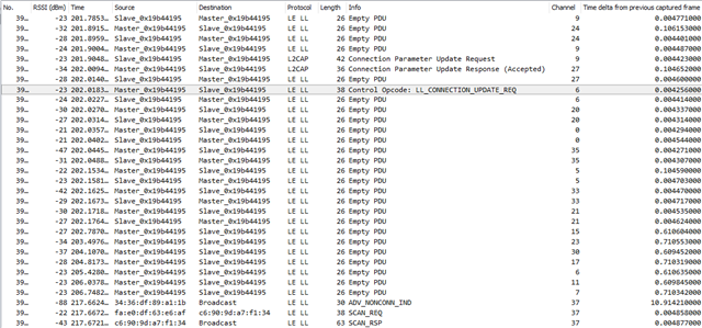

During the work the master must establish connection for long period of time (approximately for 10 minutes).  In required time the master connects to required slave and establishes connection, but after discovering characteristics it disconnects with error 8 BLE_HCI_CONNECTION_TIMEOUT.
We tried to check the slave from telephone BLE application and saw that the slave reminds connected for a long period of time. Than we tried to check the connection establishment by the sniffer and saw that the failing happens right away after the connection update. We tried to compare the connection update parameters and saw the next difference:

0> <info> app: Min Interval: 24, Max Interval: 24, Con. Latency: 0, Sup. TimeOut: 400
Master – Slave Connection termination (Sniffer output):
The slave requests for the connection update with suggested connection parameters as in example

And by default the master responds to the request with these parameters. To resolve the problem we tried decrease the “MAX_CONN_INTERVAL” and saw that the it has to be decreased  to 250ms or  even less otherwise the connection continues to fail.

  5. According to sniffer the phone and the master respond for connection update request with two messages, but in the different order: The master previously gives “Connection Parameter Update Response (Accepted)” and then “Control Opcode: LL_CONNECTION_UPDATE_REQ”       while the Phone previousely gives “Control Opcode: LL_CONNECTION_UPDATE_REQ” and then “Connection Parameter Update Response (Accepted)”. Is it possible to change the order of the commands? Can it be the source of problem too?

    I had solved the problem by adjusting "NRF_SDH_CLOCK_LF_ACCURACY" from "7" (20ppm) to 2 (150ppm).
    But this adjustment itself confused me: The connection stability increased with increasing permitted clock dispersion in ppm that means with decreasing the clock accuracy if I understand correctly the meaning of the value of "NRF_SDH_CLOCK_LF_ACCURACY".
    How does it happen? How decreasing the clock accuracy can increase the stability of connection? Or may it be that increasing the value of “NRF_SDH_CLOCK_LF_ACCURACY” in ppm increases the accuracy and not decreases it?
    In account of what the increasing the “NRF_SDH_CLOCK_LF_ACCURACY”’s value in ppm increases connection stability. What may be decreased or reduced in this case?
  • Higher ppm values means worse accuracy, and more clock drift over time. The SoftDevice takes this value into account in the BLE link layer timing.
    What ppm value you should use will depend on accuracy of the external LF crystal you are using. This should be listed in the datasheet of the crystal. But note that if you are using the wrong load capacitance values(C11/C12), the crystal will not have the correct oscillation frequency, and will drift more than what is stated in the datasheet. See this link.
