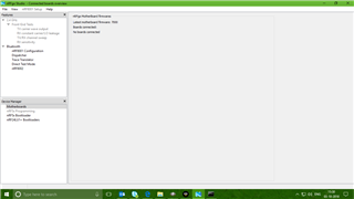

Hi
Board is working fine with if i download any program via Segger Embedded studio in windows 10. but in nrfgo studio board is not listed . i have attached screen shot given below

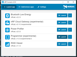

Hi Raji.
You need to add a app inside nRF Connect v2.5.0 to program using nRF Connect v2.5.0
Here is how you do it:
Open nRF Connect v2.5.0.

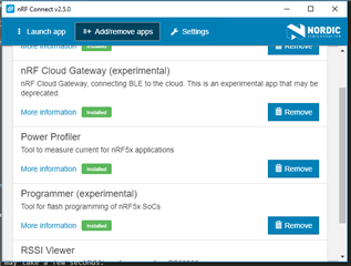

Click on "Add/Remove apps".
Find the app called "Programmer (experimental)" and install this.
(Note that I have already installed it)

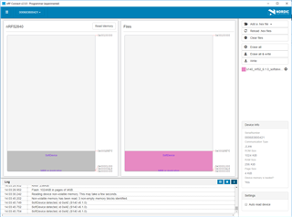

Click on "Launch app" and Launch the "Programmer (experimental)" app.
When the app is open, click on "Select Device" and select the device you wish to program.
When you want to program the device you simply click on "Add a .hex file" and "Browse", and navigate to the folder you have stored your .hex file.
For example, here I have loaded the SoftDevice S140 v6.1.0 .hex file, to program it I click on "Erase all & write"
This will do the following nrfjprog commands:
nrfjprog -e
nrfjprog --recover
nrfjprog -r
nrfjprog --program
nrfjprog --verify
nrfjprog -r
The device is now programmed with you desired .hex file.

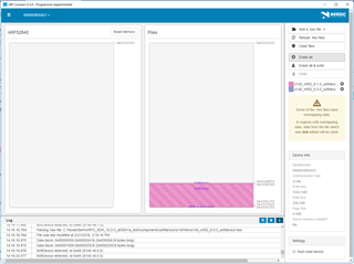

nRF Connect can also check if the flash area overlap or are to large, as you can see here:
In this picture I've added two SoftDevices on top of each other, and you can clearly see that I got an error.
Hope this little guide helps!
nRFgo should work on Windows 10.
Your issue might be that when you install nRFgo the installation also installs a very old Segger driver, and if your DK has a newer driver it might not be able to detect the DK.
- Andreas
