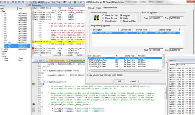

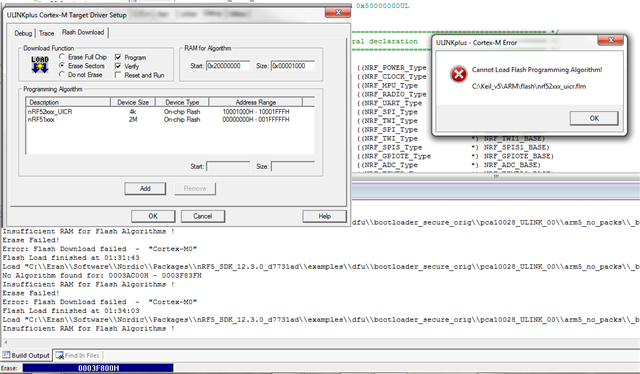

I am working with S130, sdk12.3 NRF51422_xxac
I have been successfully testing bootloader DFU example (secure_dfu_secure_dfu_ble_s130_pca10028) on the NRF51 dongle, Programming with J-LINK
however, to program my costume HW I am using arm ULINKplus,
I have used Ulink plus for application development without any issue,
Problem is When I try to replicate the steps for bootloader from NRF 51 dongle + J-LINK, to my hardware
that is : full erase, program softdevice, program bootloader

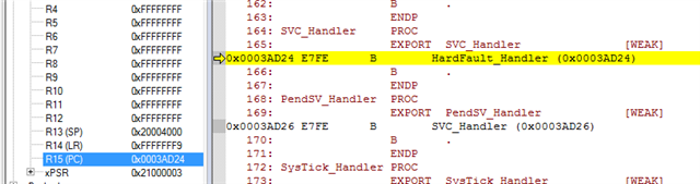

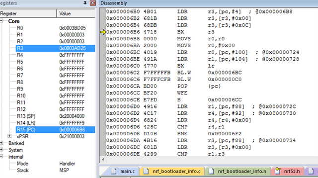

the software never reaches main() , but stuck on WFE, B instruction cycle
again,, this did not happen with the NRF51 - J-LINK
I am following the exact same steps

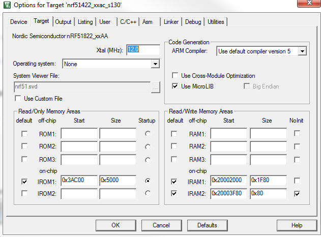

I have succeeded implementing the same applications of both PCBs, I don't understand why the bootloader should be any different,
I have looked into the memory window to see the softdevice programmed, the app area erased, the bootloader area programmed
any insight would be much appreciated,
