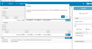

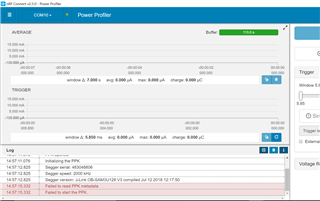

  • Hi Aryan. Thanks for the update. "As you already know that the NCP tries to connect to UART and in your configuration, the NCP does not seem to have proper access to UART pins." Could you please elaborate on this proper access to uart pins. Bcoz the problem described in earlier post is also observed with Power Profiler app along with Bluetooth Low Power application. I am using USB2 for flashing the firmware using jlink cdc uart and USB1 for data logging using console/terminal application.
    nrf connect from mobile works as expected with out any issues. But for testing the nordic sdk examples, nordic connect desktop version is prescribed. so for the desktop version of nrf connect, i neither can update firmware for jlink when i connect for the first time nor test any above mentioned apps.
    pls find the attached snapshots of using nrf connect desktop version

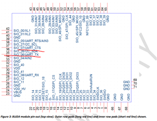

  • The segger(debug) chip  on our DK implements the driver for CDC communication from the host over UART. This debug chip in turns communicates with nRF using a fixed pin numbers as UART pins in nRF chip. If in your custom board, if the pin numbers used to connect the CDC UART data to nrf is different, then the firmware flashed into nRF chip would not be able to communicate with nRF connect.
    Make sure that on your board the com port data from your PC goes to nRF pins this way
    P5 -> RTS
    P6->TXD
    P7 -> CTS
    P8 -> RXD
    and sniff those lines.
    The above pin number is what the firmware flashed in your first image assumes that UART pins are and all the data from nRF side is on those pins. If the COM10 port is connected to different pins then there will be no communication.
    Based on the spec of BL654
    The UART pins that are being used are different than what we used to communicate with COM ports.
